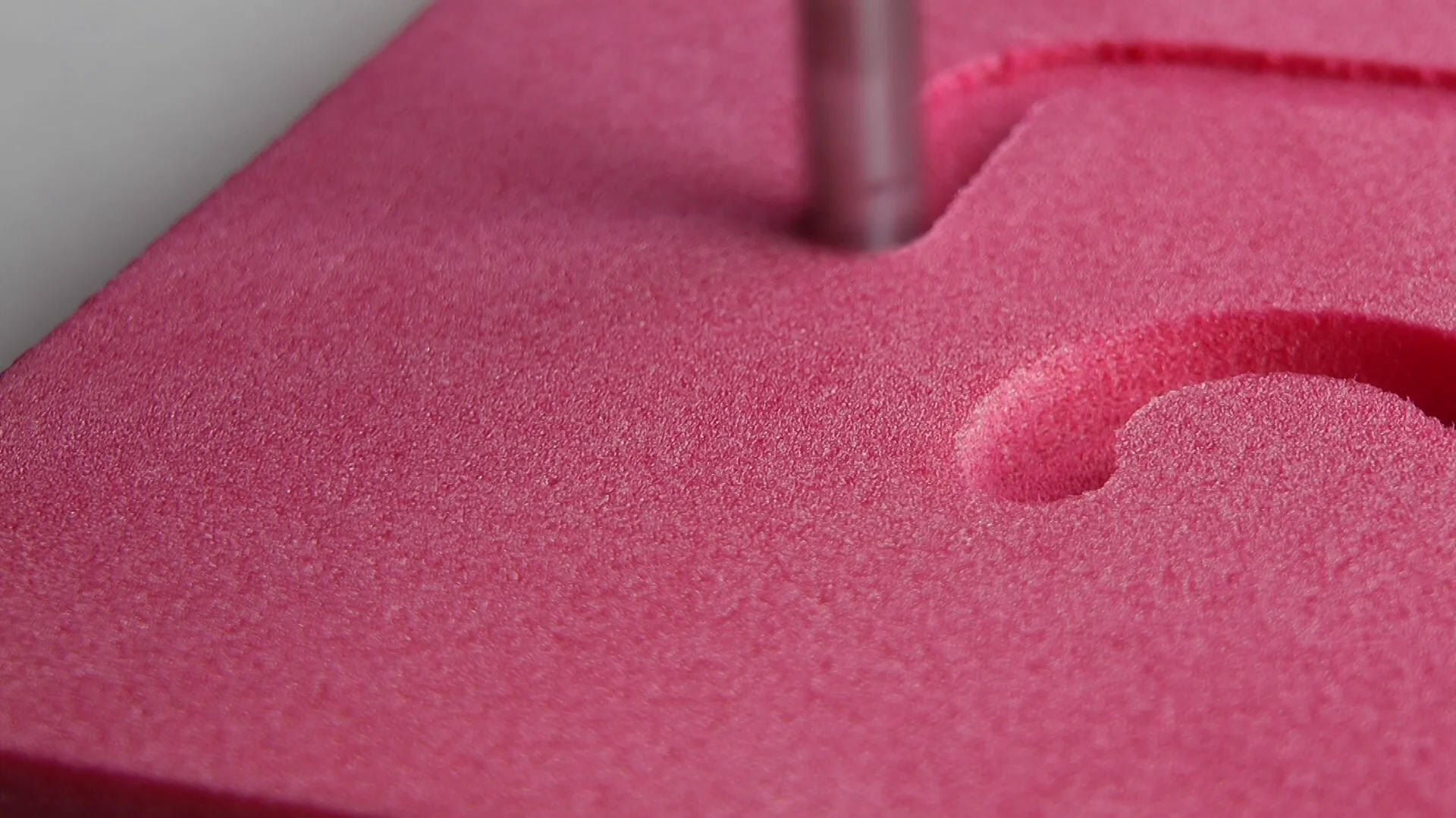

Perhaps heat is the wrong way. This looks like perfection:
But need to vacuum clean the room afterwards haha.
